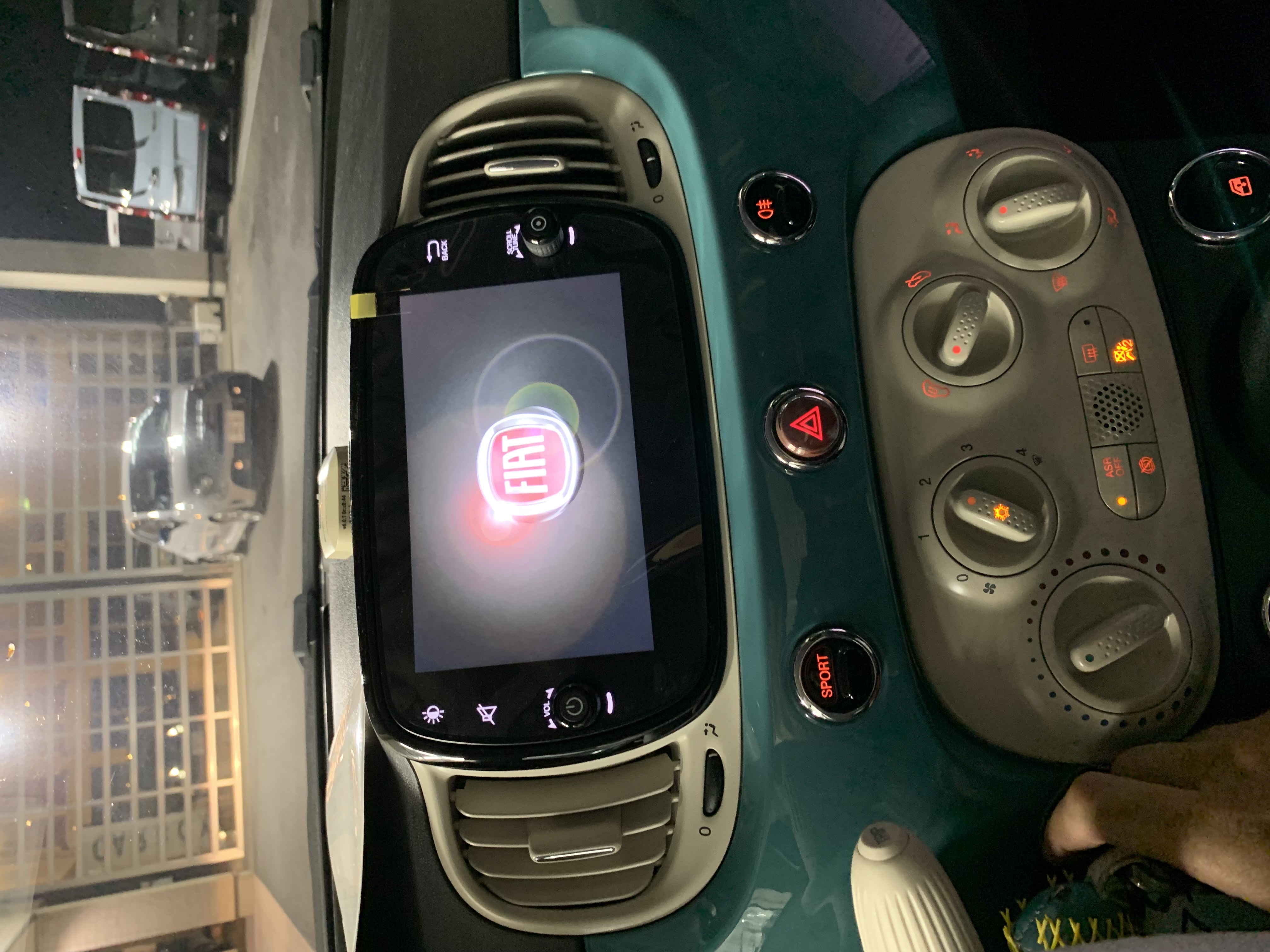

The opening has been changed from Abarth to Fiat, and the CarPlay control has been moved to the left side, making it easier to use. It was a great help. Thank you very much.
budgoz
Posts: 31
Joined: 14 Oct 2020, 23:09
Re: carplay doesn't start
Post by budgoz »
carbox wrote: 03 Sep 2024, 13:53 The opening has been changed from Abarth to Fiat, and the CarPlay control has been moved to the left side, making it easier to use. It was a great help. Thank you very much.
It looks amazing! Can you post your final proxy?

33 32 31 35 30 30 33 34 36 33 37 4F 55 54 50 55 54 44 4A 49 54 20 17 11 09 4F 80 00 05 14 00 00 00 09 00 00 04 10 00 00 00 03 C7 77 06 DB 00 1C C0 00 00 00 16 00 01 08 94 06 41 01 00 40 00 81 20 75 41 0A 0C 0D 01 80 2E 24 00 00 00 00 31 05 61 03 00 00 04 00 00 00 00 00 00 00 00 00 00 00 00 00 00 00 00 00 00 00 00 00 06 00 94 00 22 00 04 88 02 00 20 80 00 00 40 00 11 00 0F 00 00 00 00 01 80 40 11 00 00 00 00 00 00 00 00 00 00 00 00 00 00 05 00 00 00 00 00 00 00 00 01 00 00 01 00 00 00 00 00 00 00 00 00 00 00 00 00 00 00 00 00 00 00 00 00 00 00 00 00 00 00 00 00 00 00 00 00
This is the final one. Does Fiat have different openings? At first, the 120th was displayed. Is there a beets logo or something? Since it's an anniversary, the logo is the old logo.

carbox wrote: 03 Sep 2024, 14:34 Does Fiat have different openings? At first, the 120th was displayed. Is there a beets logo or something? Since it's an anniversary, the logo is the old logo.
Yes, there are different logos available at startup, including the beats audio one. Do you have a picture of the 120th?

I don't have a photo, but it says 120th on something like a record. It would be best if it had the Anniversario logo. Can you give me some codes?

Hello, I tested two opening screens. The Beat Sound logo was added. Both were the same logo. Please check. And thank you, it was helpful.
