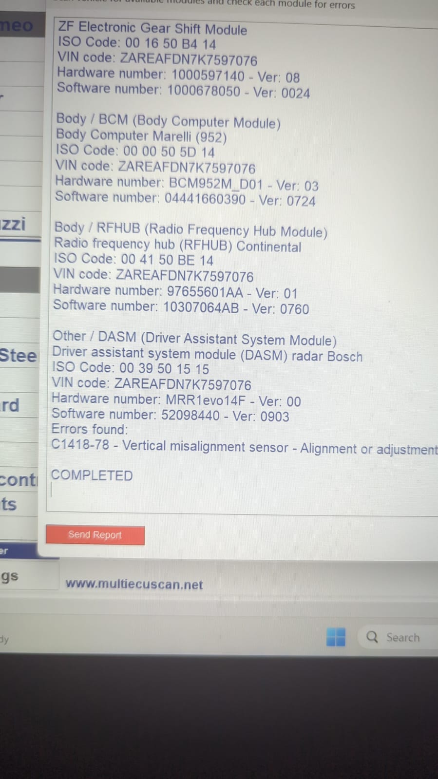

So I got an error for the bosch radar, which is missaligned vertically, now, in order to fix it, I heard there's something that can be done from MES, until actual manual aligment is needed?
ACC worked, but failed when i had 2 cars sitting in front of me, sharing the same lane per say, and when that happened for a couple of meters it threw acc error, does anybody know how to do it from MES?
Car is a 2018 giulia veloce, had front crash-bar replaced, acc worked for about 2 and half months after the new crashbar was fitted
Actual code is:
C1418-78 - Vertical Misaligment senzor, on DASM Module
Removing the error did not solve the issue (aka one time error, it is reapearing)

At what control module does this fault appear?

Hmm, other/dasm it seems, i ve attached a picture
WhatsApp Image 2024-12-18 at 09.21.26_7057a13b.jpg (130.11 KiB) Viewed 3911 times

https://static.nhtsa.gov/odi/tsbs/2021/MC-10204352-9999.pdf
Did you have a look at this article?
