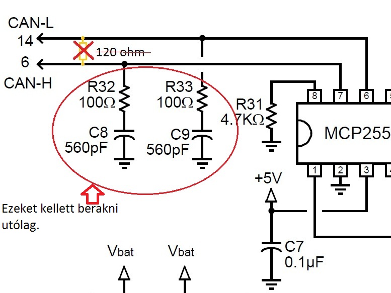

I bought the similar or same type (orange-blue label).
By an other thread in this forum, ( viewtopic.php?f=5&t=1493 ) I found the problem. The circuit board was different, but the problem was the same. The CanH and CanL was connected to eachother by an 120ohm resistor instead of connection to GND through RC circuit.
Here is a picture:
elm rc.jpg (90.12 KiB) Viewed 9381 times
So, I removed the unwanted 120 resistor and installed missing R32,R33,C8,C9. Since there my cable is ok.

I have same elm, with same resistor linking pins 6 and 7 of chip mcp 255.
will carry out the mod (120 ohm and 560 pf) on lines from pin 6 and 7 tomorrow
many many thanks to all who posted pictures and diagrams !!!
