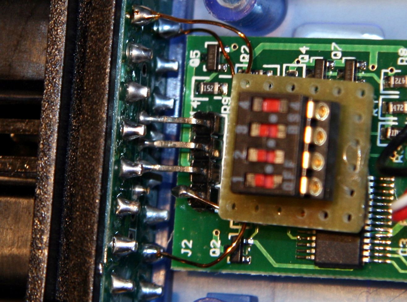

You can cut K-Line on the 4-PIN Connector to the board exactly like on the image.
@Jerry 159: I also use the cable with other cars, so i don't want to link the PINs.

Hi Hgbutte, Thanks for the picture of the K line details . A picture speaks a thousand words and I am sure that all the users are now clear on how to modify the cable dongle.
On my VAGCOM Cable from Ebay, there is a 6 pin header rather than 4 , but its just a matter of checking which pin 7 is with a meter etc.
It looks like there are several variants about, but all do much the same thing and convert signal to USB output to PC.

Hi everyone, just to let you know I modified my VAG KKL Cable with a 4 way DIL switch as in Hgbutte's post and tried the set up on my son's 2003 Punto 1.2 8V hatchback.

yani wrote:Hi,
The proper connections are:
pin 1 - ABS
pin 3 - Airbag
pin 7 - Engine/Gearbox
pin 9 - EPS
Here is what I can suggest for the cable:
1.Get a stock VagCom cable.
2.Then cut the connection between k-line and pin 7.
3.Then solder a microswitch to switch either k-3 or k-1-7-9. Where k is the k-line from the circuit board and 1,3,7,9 are the pins on the OBD connector.
Thanks for reporting that HowToUse mistake. It was just a typo.
Yani

But because i use the interface on a Volvo V70 as well, i have built in the switch, to have whatever connection of 1-3-7-9 i want to.

In some VAG cars the voltage on pin 1 switch to 12Volts when ignition on, so if you use the interface with pins 1,7 and 9 together the line K voltage will be 12Volts and the diagnosis are not posible in these cars.

Maybe my explanation will make it easier for You - as I understood Fiat group cars send signals thru pins 1,3,7,9. multiecuscan reads data only thru pin 7 on KKL interface. If you want connect with your engine then you don't need change anything (pin7 on the car connector is engine). If you want connect to ABS ECU then you must connect pin1 on the car connector with pin7 on KKL interface. Same for Airbag - pin3 on car connector connect to pin7 on KKL interface... Just solder pin1 and pin7 on KKL interface connector and you are always able to connect with engine and ABS. I think now is more clear and you will find out how to connect with airbag without taking risk of soldering pin3 with others...

yes - exactly like you wrote, but as Yani said - it's litle risky solder pin 3 with others then is recommended to cut out connection between board and pin7 inside KKL interface and manualy connect (by switch or just cabel to cabel) board with pin3 for airbag reading and board with pin7 for engine, board with pin1 for ABS.
