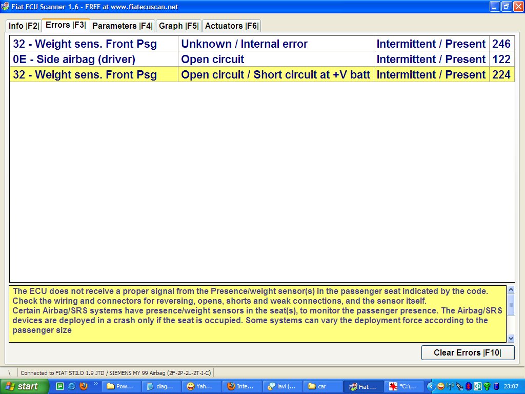

hello,
i have the usual problem with seat ocupancy sensor. it's not any more on my seat, i dismounted it and tried to repair it but it's imposible to do that so i have the only 2 options: 1 to disable the seat passenger airbag forever at local fiat service and second to buy a new one.
do you think that it's possible to disable that sensor forever?
i am working at that for the moment, and if i get a better sollution i will let you all know!
thanks for the great work!

There is a third option.
If its a Stilo model, you may buy a little circuit that simulate the sensor, only need connect 3 wires, very easy, car will detect always it active.

We also gave emulator
