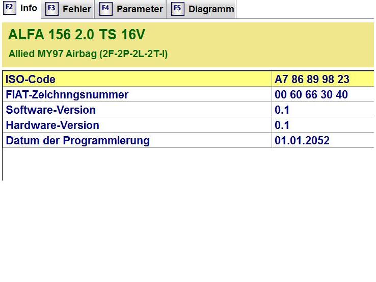

My Alfa 156 is built in 1998 and my airbag problem with FES
read
read
- Airbag 156 a.jpg (44.89 KiB) Viewed 8925 times

Hi Eddy,
I also tried this one (2F-2P-2L-2T-I) and did not get an connection.
Did you see the date where your airbag module is supposed to be programmed ????
Kalle

This fuck airbag system all with the Nr 707 use a allied signal which is not supported by fes and also AlfaOBD doesnt support it.
Also Examiner did not read it 3 airbag ECU all the same Fiat Examiner can not read it!! unbelievable!!! Thats the reason why FES doesnt support it
no machine can read it, unable to be copied
Solution update to a new ecu system from 2003.
