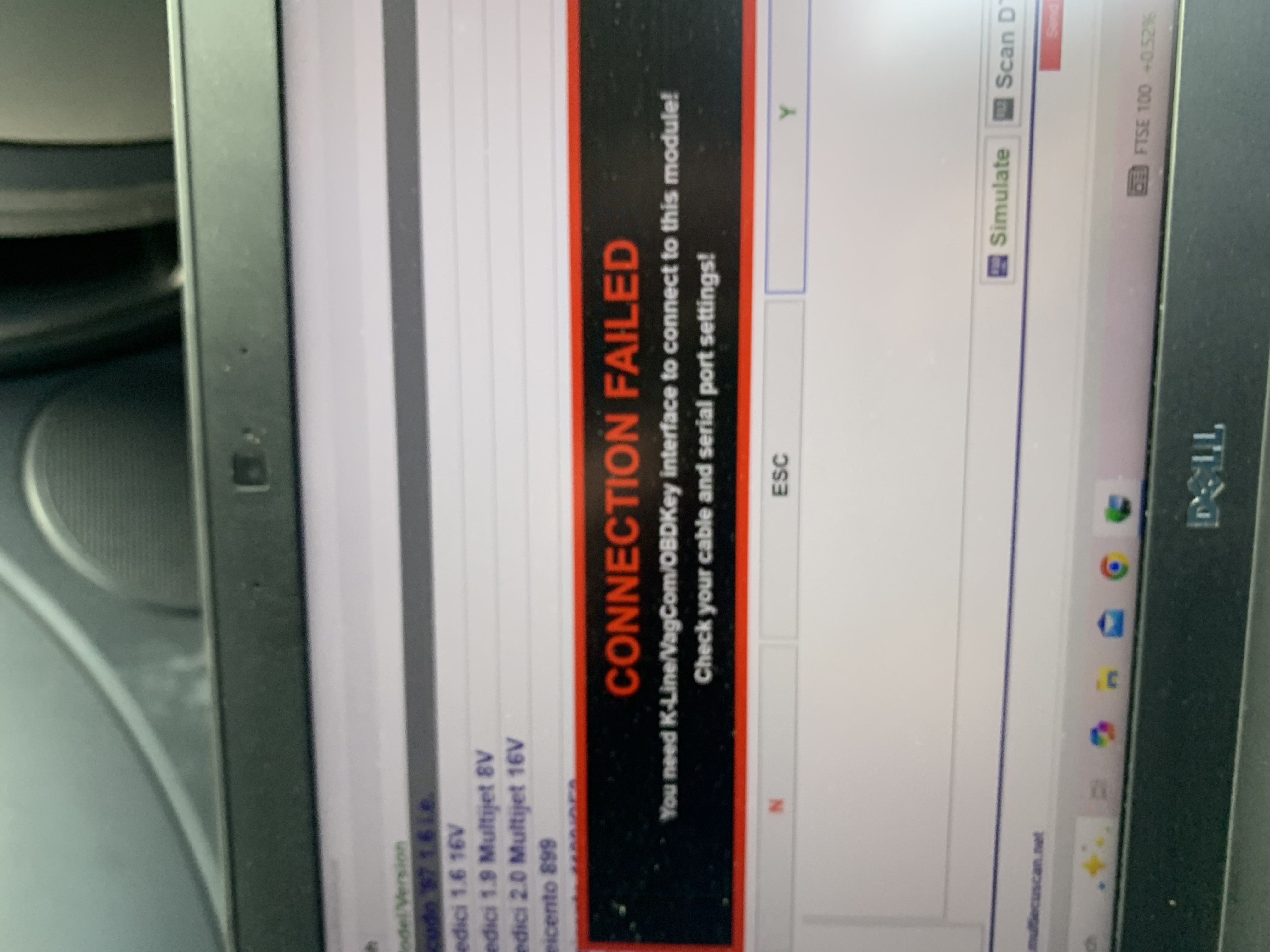

When i go in settings then interface my vgate vlinker is seen and says success
When i try connect to scudo van 2012 is says this in the pics
Can you tell me which it is asking for?
s130
Posts: 1053
Joined: 20 Jan 2010, 10:07
Re: Odb interface
Post by s130 »
I don't think VGATE supports the older KKL/VAG protocol. ELM interfaces don't either.
See here: https://www.multiecuscan.net/SupportedVehiclesList.aspx
Scudo requires KKL interface.
Fortunately KKL interfaces are not expensive and unlike ELM the various KKL versions always work.
