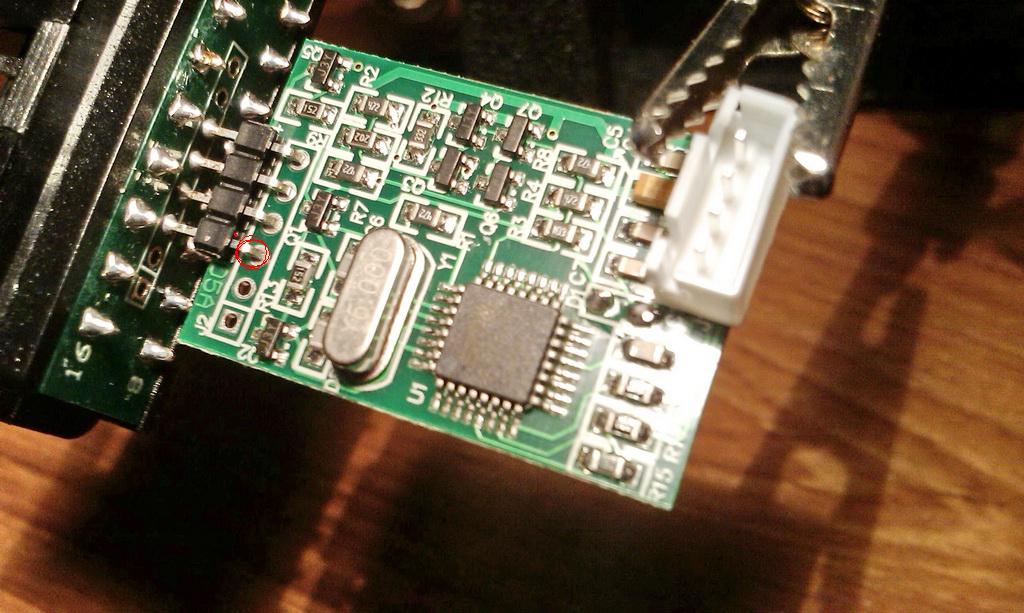

I modified elm I connected pin 7 pin1 and in doing so when they connect with me on multiecuscan ABS works. Now I want to connect the pin 9 and pin3 AIRBAG EPS.Per operation of these two pins should I connect them to what?. Among them, the pin1, 7 or another pin?. The other guides do not understand well. said connecting pins 1,3,7,9. But do not specify whether among themselves or another specific pin or a pin of these runs are listed all the other pins.

See this for pin functions: viewtopic.php?f=5&t=1328
Pin 7 on the ELM327 to J1962 connector is the KKL line.
For airbags 7 must be connected to 3
For engine 7 is left asis
For ABS 7 must be connected to 1
For body computer, power steering 7 must be connected to 9
It is not recommended to have pins 1,3,7 and 9 all connected together at the SAME time.
Pins 1, 7 and 9 connected together appears to work for most people.

I pin7 connected to pin 3, but works with ELM airbags nn I says to use KKL.
The 3-pin socket is always on you connect to the machine right?. Why I read tab welded pin 3. What is this? Watch immaine.
- IMAG0036.jpg (115.58 KiB) Viewed 4786 times
