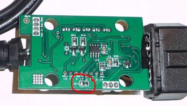

If your interface cannot connect to the body comp, you will need to open it and then remove following resistor
http://forum.multiecuscan.net/viewtopic.php?f=5&t=1462- Attachments
- 284176512-elmfix4.jpg (79.36 KiB) Viewed 1185 times

I have the same problem with my ELM.
Test gone through and everything is OK.
Does this change on the resistor need to be done, or do I have something made wrong.
Motor ECU connection is running, but nothing else.
/edit
Just used the search here and found out the thread of Yani, speaking about the "faulty" ELM327.
There you need to solder also the capcitors and resistor, and remove one resistor.
Here it's mentioned to remove only the resistor.
Which is the right way?
