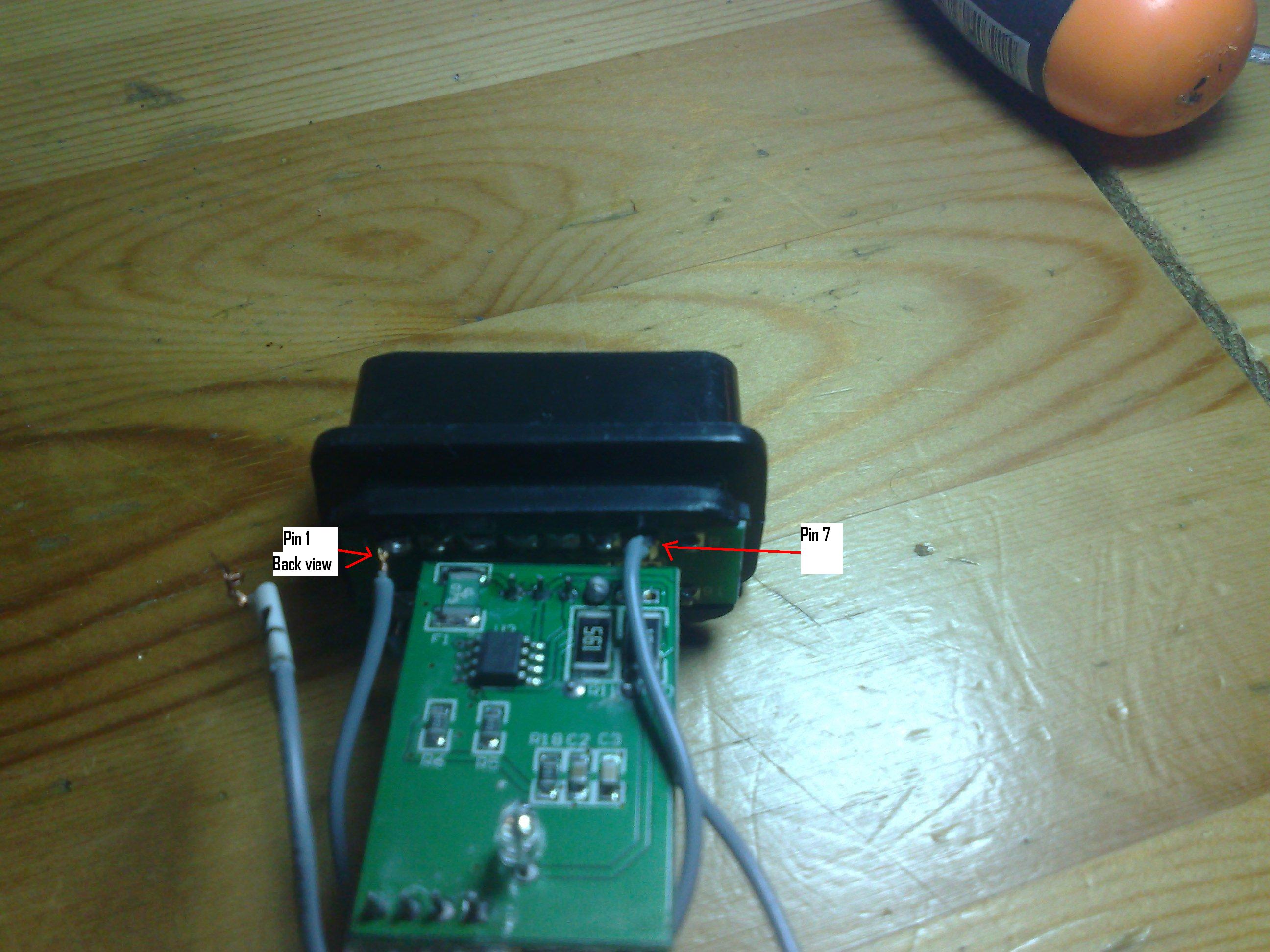

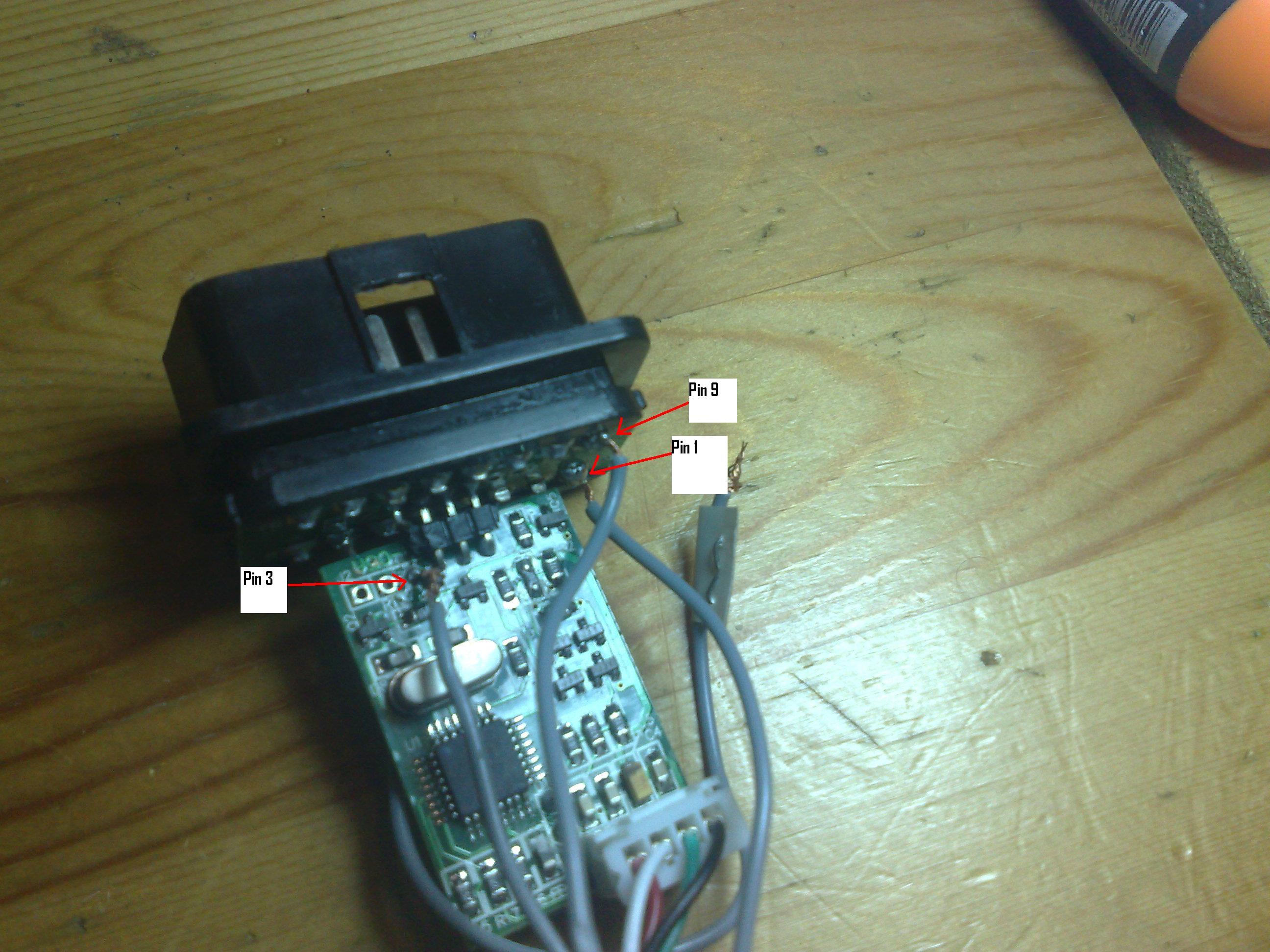

Hello, I soldered pins 3,1,7,9. But I can not connect airbag
Immagine.Cosi place you tell me if I done something wrong
Thanks!

It is NOT recommended to connect all the pins together.
Pin 7 to 1 and 9 is OK BUT not to 3 at the same time.
7 to 1 and 9 is OK (ECU & ABS & EPS & Body) is OK
7 to 3 (ECU & airbags) is ok
