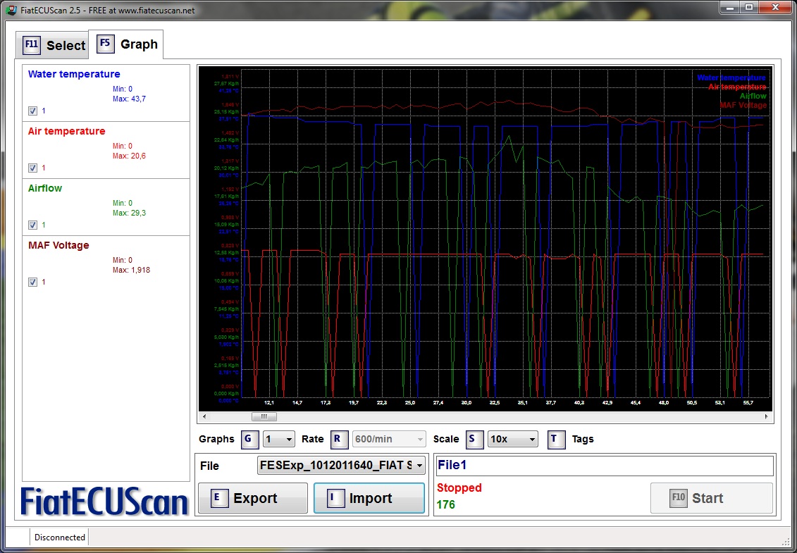

UPDATE2:
I also replaced the accumulator and the clutch solenoid, but that did not help either. I was monitoring the engine ECU and especially the MAF sensor when i saw something strange;
You see that the values air temperature, air flow and even water temperature drop very frequently. I assume this is not correct.
I could conclude that the MAF sensor is gone but why does the watertemperature drop also? this isn`t in the MAF sensor.
Anyone experience this before? i attatched a larger screenshot to this post
