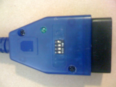

Cable type with Dil switches for Engine ABS Airbag ECU's

can you please tell me how to make microswitches fix so that thex dont move around if you understand what i am trying to ask you, i know how to connect them but i dont know how to make them tighten?

Super glue the switch housing in place.

Or just cut out the DIL switch size in the plug, so it fits in there. I didn't even use superglue. It sits nice and tight.
