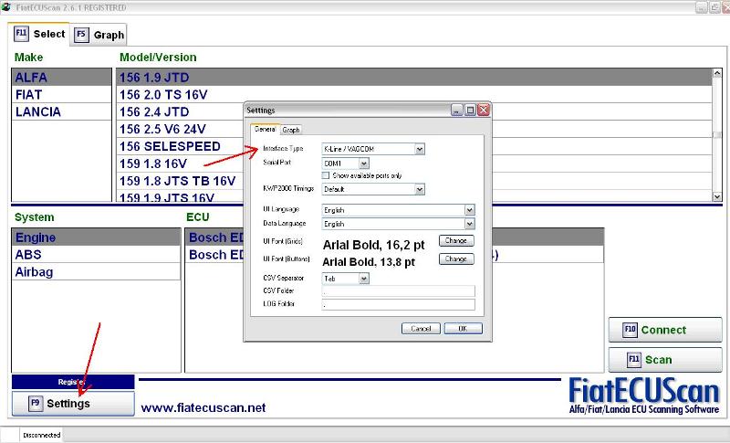

Re: Lancia connection problems
Hi there in Sarajevo if that is correct - hope things are fine with you
And thank you for these very straightforward instructions. At last I get it!
But where do I find the KWP2000 timings so I can set them to default?
Look here:
- FES-main screen.JPG (71.27 KiB) Viewed 8680 times
Thank you - but no change.
I went to the garage today and they had the codes out in 5 minutes so at least I know it can be done with my OBD plug.
It would be great to be able to do that myself but this setup I am sending back because it refuses to work at least in this configuration.
I was able to learn a lot thanks to the generosity of people.
If I get another interface to work properly I will post it here so others can benefit too, even if the Lancia K 3.0 is not so common.
Thanks again
