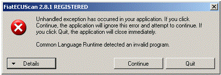

Hi Yani,
I just updated my 2.7 version to 2.8.1. Now I get the following message every time I try to start FES.
error message.gif (19.76 KiB) Viewed 5310 times
After I click OK, I get this screen and nothing more is happening.
FES screen.gif (1.41 KiB) Viewed 5310 times
Whats wrong?
Thanks a lot!

The problem is in the version of .NET Framework which you have installed on your PC.
You need .NET Framework 2.0 with SP1.

Hey guys,
thanks a lot!
I installed .NFW 3.5. Now the SW is working again! :-)
