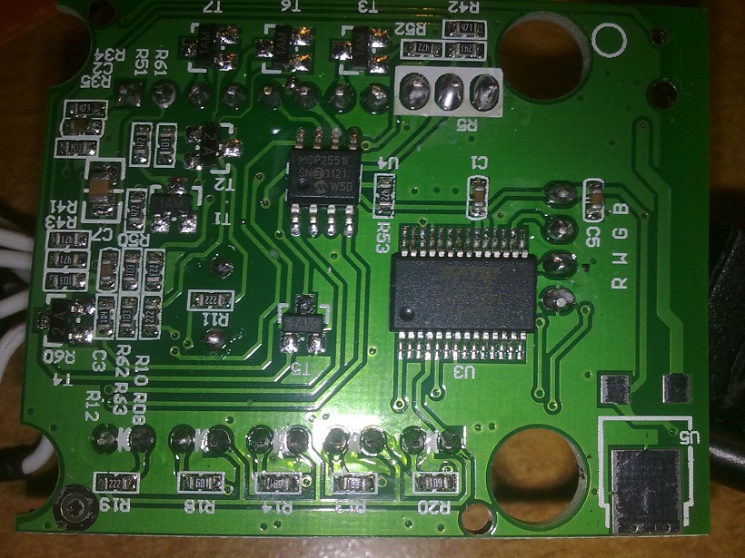

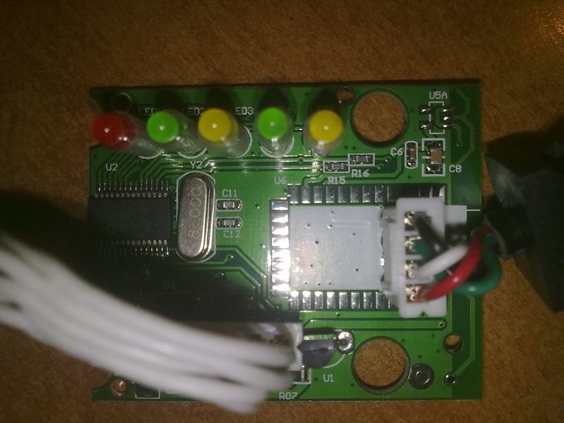

This is the photo of my ELM board:
http://imageshack.us/photo/my-images/220/elm1a.jpg/
http://imageshack.us/photo/my-images/38/elm2.jpg/

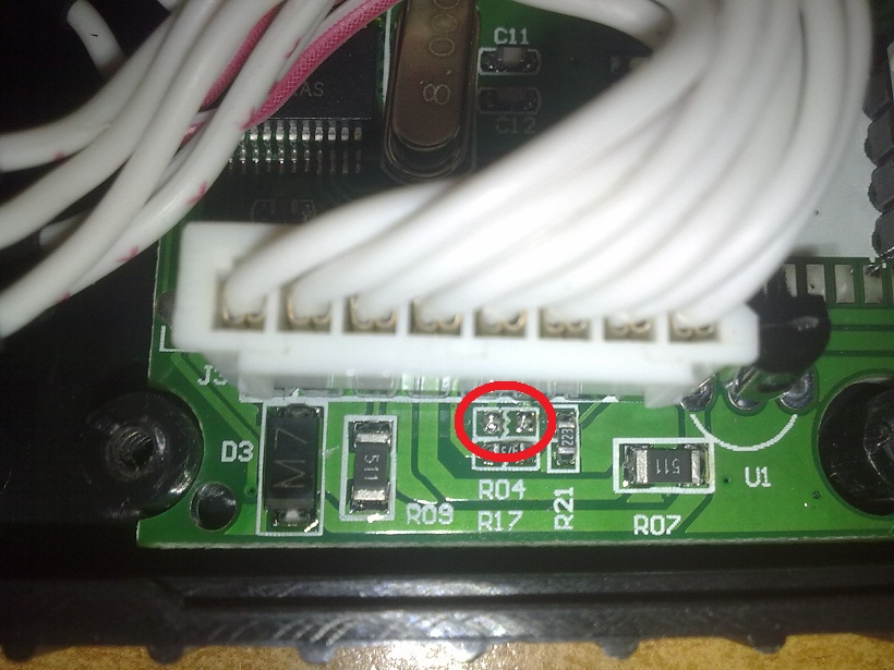

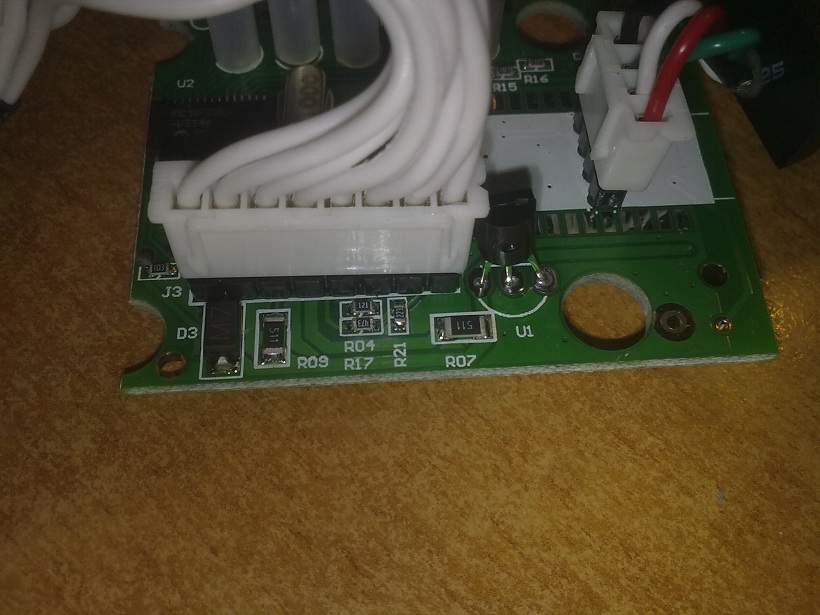

I have call the seller of the interface, he told me only remove R04 (see immage attached) from the board
Now I can connect to CAN....... I think this is V1.5 FAKE
need capacitor's and resistor's??

No, you do not need to do more.
These Interface v1.5, pin 6 + 14 R04 with this resistance
connected and that can not recognize and does not connect Multiecuscan
her.
The error with the resistor R04 R14 was also partly here already
more than once.
viewtopic.php?f=5&t=1493
her.
more than once.
