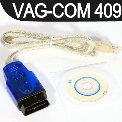

I understand what you mean! I had the same experience regarding VAC COM KKL USB interfaces.
I think there is a difference between two VAG COM interfaces. Even if they have same marking and they look almost the same but they are totally different!
When you open them and when you look inside of them you can see difference on the mother board...
You can see photos...
- VAG COM KKL 409 cable GOOD.jpg (118.45 KiB) Viewed 9386 times

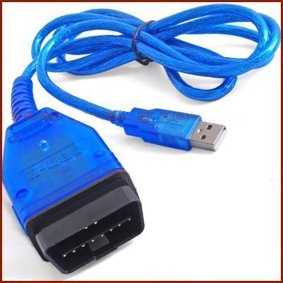

Re: Ecu airbag
And this one is different!
- VAG COM KKL 409 cable BAD.jpg (26.08 KiB) Viewed 9386 times
Re: Ecu airbag
The cables I have are the same as the second picture, but inside the pcb is different. The integrated FTDI cables are in two different, I think there is the problem, there should be a difference in the velocities off communication.
