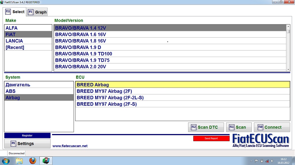

I´m testing your newest version 3.4.1 to read the airbag from a Fiat Bravo 1.9 JTD 3 pin.
But it will not connect
I tried out all settings. whether default.slow,..... with and without high latancy
I come to the ecu
When I try it with ALFA OBD, it connects only sofort.Aber you do that, not alfa diag
Where is the problem
Do you think you can do that times beheben.Wäre great.
'm Not the only one who would be delighted.
Or do you know why it does not work or what you have to change yet?

I can only advise to pay attention to an average white-blue wire: it is a L-line. In a usual 3-pin adapter an average wire a N-line (a minus of the accumulator).

Hello Yani.
The same problem: it is not connected to safety pillows on Brava 1.4 1996. No errors, appears only "Send report" and it is all.
