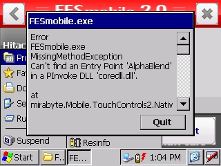

At first, I installed it to a Windows Mobile CE (PNA GPS for exact) and I have an error when execute the fesmobile.exe file (simulate or connect). I haven't attach any bluetooth interface yet.
Is it OK, because is missing the interface or something goes wrong?

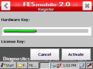

At second, If I get the licence code, how insert it on this screen? There in no scroll to down for Licence Key Area!

Can you check which version is the Windows CE system?
I will release a new version of FESmobile soon and want to check/fix this problem.

At the previous screens like trade, model, motor/abs/etc can you to scroll down.
It is missing to Registration Window, only.
The resolution of screen is 320X240

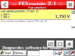

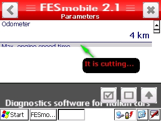

Yes Yani, the execution problem is dissappering now, I tried the new FESMobile2_1 in demo mode without any interface.
I have some observations for the development of your software.
My resolution is 320X240 pixels.
At first as you can see, there is a cutting of the list. The scroll bar is OK, but the screen of parameteres has very short height. The same hapening if you checking any parameteres.

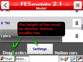

Second, you must to decrease the height of bar with the text "Diagnostics software for Italian Cars" as the button "Settings" size too.

Re: Execution Problem
That's very strange. The operating system in this device does not give proper scalling and does not properly handle the image transparency. This is usually handled well in CE5.0.
Can you try to rotate the screen 90 degress and run the program (i.e. in 240x320 instead of 320x240). And also can you try to hide the task bar when running the proram?

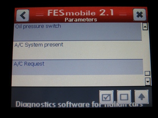

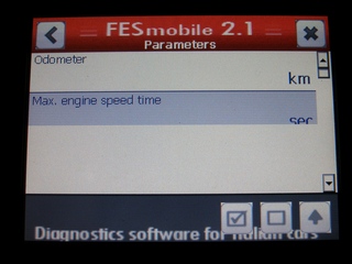

Yani, I hided the task bar and there is little improovement (appears about 95% the second line) but no third line.
But, if you scroll down to the end and click once time to the up, appearing the third line. If you click a more that once, again the third line is dissappearing! This is very strange!
The win CE 5.0 doesn't any rotate the screen at Settings/Control Panel/Display. The resolution is fixed.

Post by lancialybra »
The phenomenon of losting of 3rd line happens only to parameteres. The info, errors, actuators work fine with the three lines OK.
