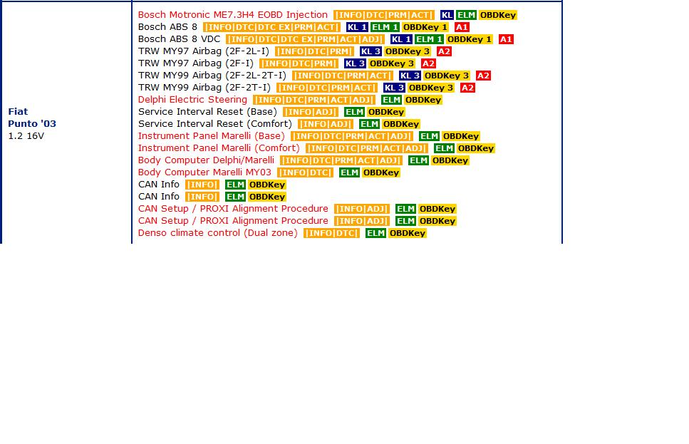

What is the Punto 1.2 16V to you?
If you are with the unregistered version can not connect as a registered version is required. (Red-written controls)
This is normally displayed in a frame
If the scan your controls appear you also no error in the port setting or a driver error
One would have to know whether e.g. your airbag control unit is at all to read with the ELM?
Is this your Punto ?

Now that I know what you Punto, I can say
- For your ELM on your Punto you need no adapter
- The Multiecuscan test only tests the CAN protocols
- Your ECU but read about KWP 2000 and has nothing to so with the test
- All you need for controls to be read with the ELM purchased the MES version
- For ABS and airbags you need a KKL interface with adapter or modified
