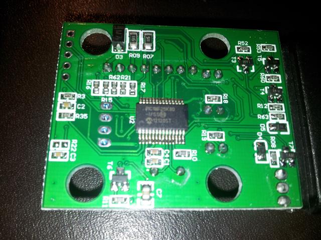

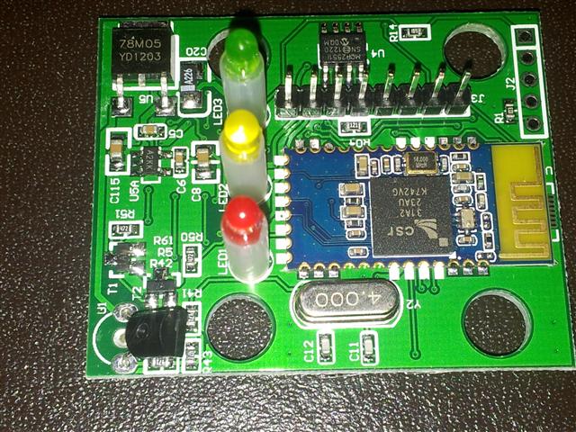

Hi Eddy ,
thanks for the reply - I have taken my interface apart and it looks quite different maybe cos it's a bluetooth one - do you think this can be modified or should I buy a better one ?
thanks

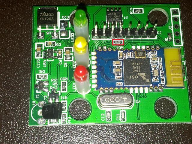

Hello Saint Etienne
I marked in red the resistor to be removed .
Remove this and then your ELM also works in the CAN bus protocol

Eddy , thanks a million - up and running ! :D
