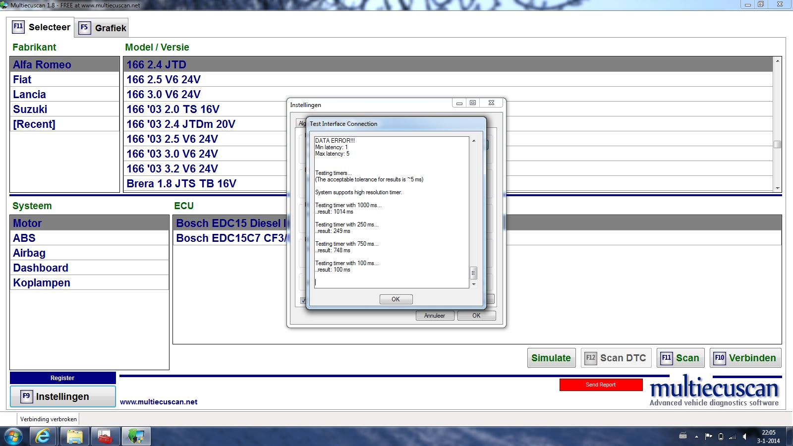

Can somebody please help me with this problem:
data error ecuscan.jpg (290.14 KiB) Viewed 4001 times
I can't get any connection to my ECU, or other modules. It says about 500 times DATA ERROR!!! and it ends with the screen in uploaded..
I set all the parameters as in the manual on the multiecuscan site.
Thanks,

Go to Windows : Control Panel : Device Manager : Ports
There you should find your KKL device. Open this (double click) and go to Port Settings tab. Check and set the device to 9600 bps, 8 bits, no parity, stop bits 1, flow control none.
NOTE THE PORT NUMBER - eg COM5
Now try MES again with the recommended settings form the MES manual and the correct port number.
If this fails then go into MES, hit PF9 (settings) and select the Intefaces Tab. Check the settings on Interface 1. This should be K-Line and ComX.
Also make sure you do actually have a KKL interface and not an ELM interface as setting the wrong one will also cause you problems.
If you have two interfaces then I suggest set them both up in MES.
Point to note! Always try to use the SAME USB socket on your computer. This will ensure that the same port number is used.
Plug the KKL interface into you chosen USB socket. Go into Device Manager (as above) and check and note the port number.
Now remove the KKL cable and plug the ELM cable into the same USB socket. Go back into device manager and now check the port number, which will almost certainly be different.
Now is MES settings set up Interface 1 with the ELM port info and other settings and then set up Interface 2 the KKL port info.
Now you should find the MES will select the right port and other settings depending on which interface is connected to the computer.
