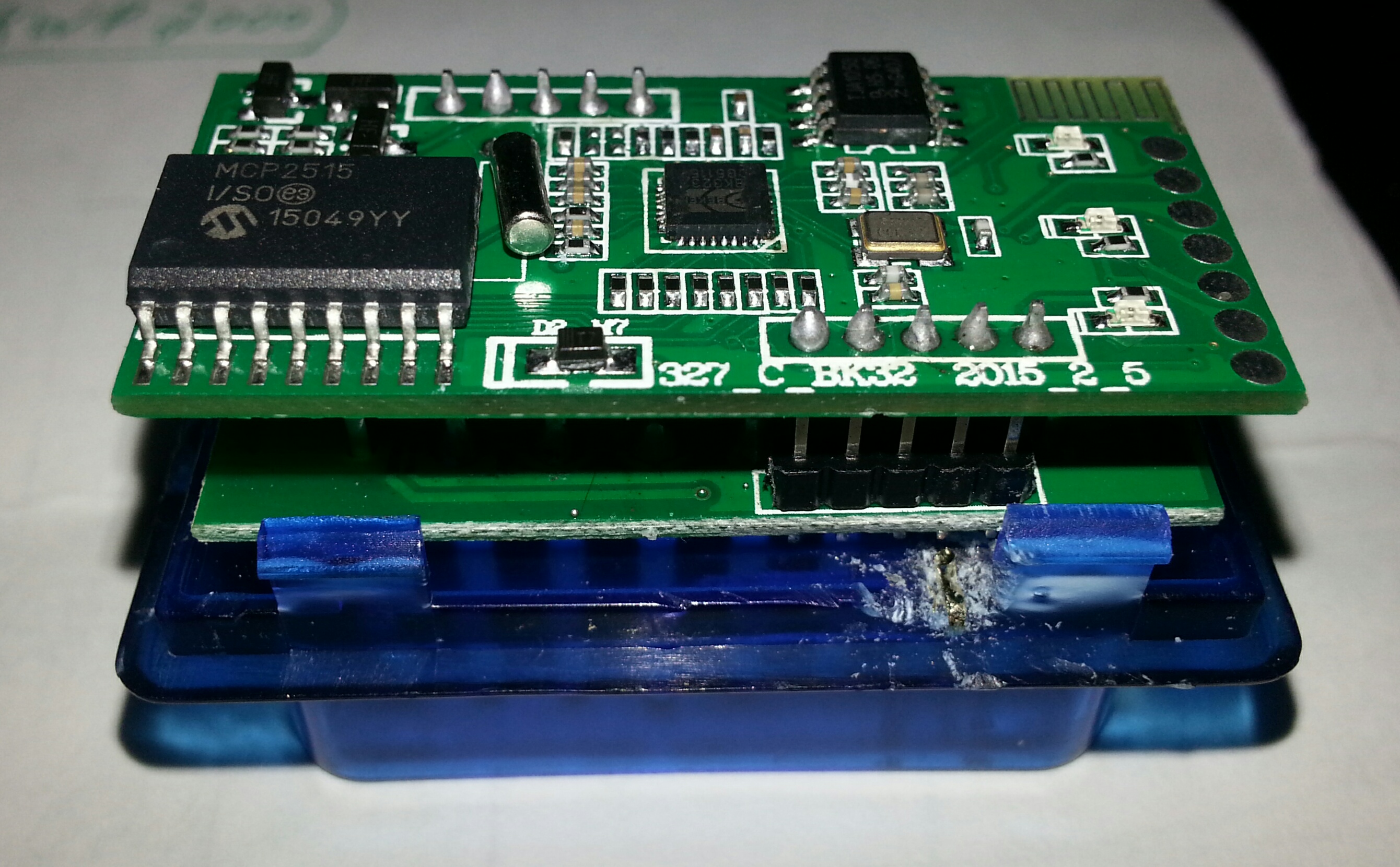

Hi. Here is a pic of the elm 327 mini opened
Thanks for any help.
happiness133
Joined: 04 Dec 2015, 07:51
Re: fix mini elm 327 bluetooth
Post by happiness133 »
Discussed many times. Read and google.
Look for a 120 ohm resistor between 6 and 14 pins, remove, happy.
