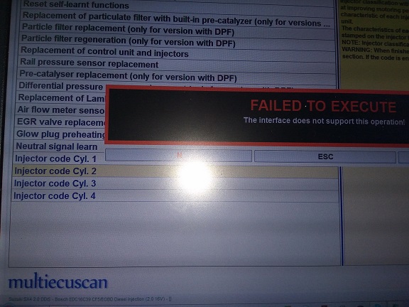

I am trying to save the new diesel injectors codes with my Suzuki, but getting the following error from MultiECUScan
"The Interface does not support this operation"
All other functions of the programm seems to work fine. The car is
Suzuki SX4, but has a Fiat Motor, 2.0 Diesel, Bosch Control Unit and injectors, Motor Code D20AA
I am using the ELM 327 Blue Interface cable.
Am I using the wrong cable? Which one is the right then?
Did anyone have the same problem, please?
Thanks,
SamuraiSuzuki

Shall I use KKL cable?
I have tried to code injectors with a help of a professional worksshop and it was okay. But I still wonder why it doesnt function with me. It should!
Re: Error while injectors coding "Interface doesnt support this function"
Whilst the support info for the Fiat Sedici specifies KKL or ELM then I am thinking that it is KKL you need for injector coding.
As KKL units are so cheap and generally reliable I would suggest you get a good quality KKL cable and try with that and report back your findings.

Yes, FIAT KKL Cable solved the problem. I saved the codes without any troubles.
