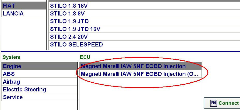

The image below is from a laptop screen size of 1024 x 768. As you can see it's not possible to know what the engine options are as the lower description disappears because of the unnecessarily large font size

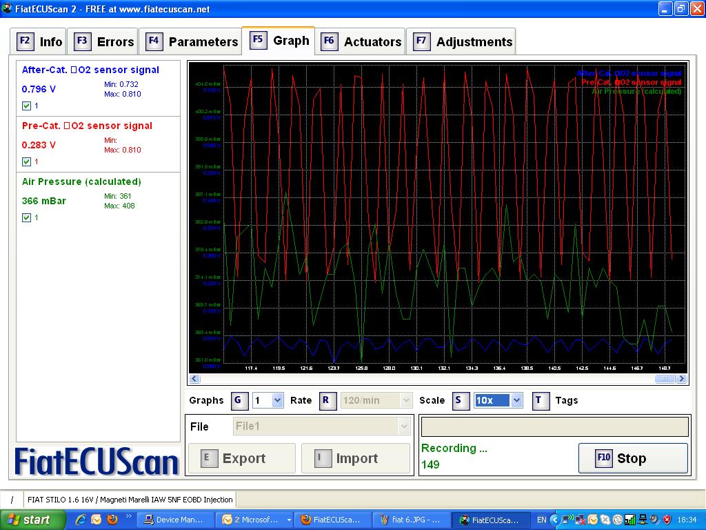

The parameter graphs in ver 2.0 seem harder to read clearly than previous versions which had more separation distance between the traces. The scaling is on maximum 10x here for the horizontal but it's difficult to see anything clearly.

- unclear graph output. Maybe grey background would be better? Graph options for colours of traces etc need to be on this screen
- fiat 7.JPG (163.82 KiB) Viewed 6792 times
- can't see the options description
- fiat engine select.JPG (62.66 KiB) Viewed 6791 times
