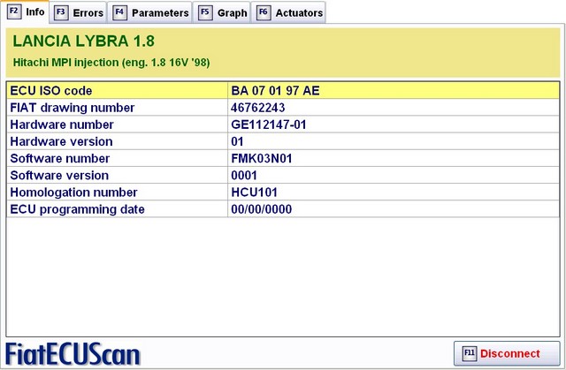

I used the Multiecuscan today, for the 1st time (Version 2.1 demo) on Lancia Lybra 1.8 (pre-EOBD, made 12/1999, Hitachi MPI). I had some disconnections when runs some engine parametres and many diconnection when plot a graph, and I need to connect ECU again all the time. The ABS & Aibag section works very well.
Is this a bug with this Hitachi version or it is usual on demo multiecuscan version?
