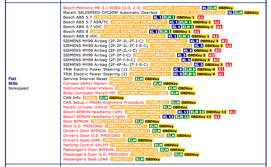

When I do a search in MES for available components I only get the motor and selespeed gear box, but from what I can see from the website almost all the components of a stilo selespeed should be available with an ELM interface.
What am I doing wrong? :geek:

Actually I bought my ELM at a dealer who only deals in diagnostics tools for cars.
From what I can read the resistor modification is only needed if the interface doesn't work at all, but mine connects to both the engine and gearbox.
Shouldn't I be able to connect to the Marelli Climate Control Unit without any adapters?
Skærmbillede 2013-10-21 kl. 17.33.33.png (194.1 KiB) Viewed 2854 times

I opened up my ELM today and found that the termination resistor was of course wrong, so i removed it and, voila, everything worked :D
\Benjamin
